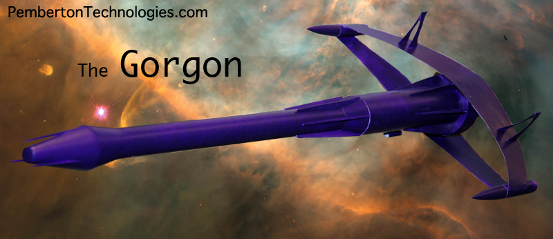

First, "the Gorgon"
She consists of a Semroc BC-1043 nosecone (topped with three short sections of toothpick), a short length of Series 10 BT, a S-10 to BT-60 balsa transition and a short length of BT-60. The after section is a 1" length of BT-80 that supports the poster board wings at their midpoint.
The reverse cresent wings, connected to segments of Bt-5 at the tips, these segments are topped by Hartle resin NC's.
She has a single 24mm motor mount but I also built another version that has dual 18mm motor mounts.
So far she hasn't flown, but I hope to see her madien flight at Southern Thunder 2010.
The final finish will have gold highlights over the purple base coat. And, by the way, this was the second model I have painted with an airbrush. It took quite a few coats but I finally got it covered.

Nice Layne I really like the Gorgon! I have a few scratches I need to build, but I make a habit of at least having a paper sketch before firing up RockSim, that way if I run into a constraint from the program I don't change the idea, and wind up with something I didn't intend. (not that the unintended result is always bad just not necessary what you wanted) Can't wait to hear how they fly!
