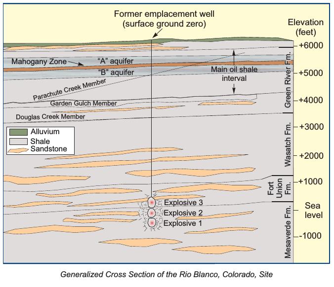

Project Rio Blanco was an underground nuclear test that took place on May 17, 1973 in Rio Blanco County, Colorado, approximately 36 miles (58 km) northwest of Rifle.[2]
Three 33-kiloton nuclear devices were detonated nearly simultaneously in a single emplacement well at depths of 5,838, 6,230, and 6,689 feet (1,779, 1,899, and 2,039 m) below ground level. The tests were conducted in fine-grain, low-permeability sandstone lenses at the base of the Fort Union Formation and the upper portion of the Mesaverde Formation.
This was the third and final natural-gas-reservoir stimulation test in the Plowshare program, which was designed to develop peaceful uses for nuclear energy. The two previous tests were Project Gasbuggy in New Mexico and Project Rulison in Colorado.

As a long time CO resident, I remember this. Yes it worked. Jeff nailed it, the upshot of this was that it would work but the gas is too radioactive to use. I don't know how they could have believed anything else could happen. I think they just wanted an excuse to touch off a nuke.

Far as oilfield fracking, nope. Anyone who thinks this is an idea worth entertaining clearly doesn't work in the oilfield, or at least they don't understand fracking operations. Fracking is done with controlled pressure and tiny "beads" that work into the micro-fissures created, to hold them open after the pressure is released. It's a relatively slow process to expose oil that is otherwise hard to get to. Nuclear heat would have the opposite effect in some cases, fusing sandstones into glass, etc.

I design pumps for a fracing company (no "k" in fracing, it's a contraction of hydraulic fracturing). I've heard stories about the company being involved w/ various atomic projects, doing a lot of cementing work for DOE in Nevada. Interesting to see our equipment in the Longshot video (around 5:24). But I was always puzzled why they thought an atomic blast would be good to frac with. In the early days of oil fields, drillers would drop nitroglycerine into a well and set it off to increase oil production. The rubble created by the blast sometimes *decreased* output because the fines, etc. would block the oil flow. That is one reason hydraulic fracturing came to be (1949). As OGG states above, it is controlled and they are very careful to make sure the channels aren't blocked...the "beads" (usually just finely graded sand) prop open the fissures created by the hydraulic pressure. At one point the industry was looking for spherical proppants (glass beads, ceramics, carborundum, etc) to provide even more control over the "permeability" of the flow channel, but with the advent of horizontal drilling and the shale plays, fracing has become a commodity market, and customers don't want to pay for high priced proppants, so sand is mostly used now.

On my tour of a few of these fracking sites before I had a vehicle equipped with GPS, I couldn't find the site near Rifle, CO described in my first post in this thread, so I stopped into what looked like a major natural gas facility which I just measured via Google Earth to be only five miles from the location of that 99kt shot. They had no idea of it!!!
I used to have a PDF describing the specifics of the water tanks they placed between the devices with a nice diagram. Can't find it right now.
