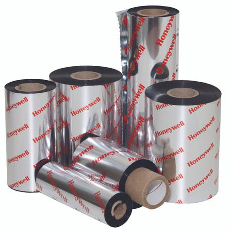

Saw this in the Uline catalog. They keep mailing me their thick catalog so perusing it for interesting materials. It probably wouldn't crinkle from the heat but you have to buy about a mile of it.

You don't want these. They are for laying on a surface and using hot lettering, transfer print to the object. The print is wax and will melt and stick to everything in a rocket.
