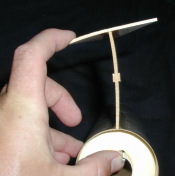

The potential problem for the upper fin is the direction of the basswood grain. First off, it is a good thing that it is basswood because these fins would not survive if they were balsa. However, the grain on the upper fin is parallel to the body tube verses the best known method of having it parallel to the leading edge. Notice the flex in the upper fin? Will it snap? Time will tell.

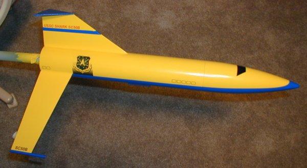

P.S. Like my paint? Left over from my misfortune on the Tour De Deuce.

Cool paint job! I had built this kit also & launched it four times, one with an "E" motor(that went up high!!). You must be pulling real hard to get the basswood fin to bend! The bend does not look all that much though, it would have to hit REAL hard to crack the fin. It was nice that they included a spacer for the shorter "D" motors! There were some typos but all in all a real unique kit. Not the standard 4 fin & tube type rocket.
I built mine just the way it looked in the auction, hmmm I think next time I will try a unique paint job!

Nope I wasn't pulling too hard. Just the flex of the grain.
Yep agree that the basswood is the way to go, but alas, with one awesome-to-watch flight on a D12-3 (slow lift off, very stable, good pictures which will be on the EMRR soon), it landed on that upper fin and cracked it!
I will fix it and it will fly again, because I love the looks of this rocket. It has real potential, but others should be cautious of the upper fin.
A simple fix - epoxy/paper covering. I should have done that, however, most often I build per instructions to give a unaltered review of a kit.
From a kit perspective, instead of running the balsa strip parallel to the body tube, run it from the upper corner diagonally to the bottom-rear corner. It would still look good and be a brace.

Check out my hypothesis of why my tail fin keeps breaking while Aron's doesn't.
Aron can you check the location of your kevlar attachement?

Right, mine is too. What I'm asking is as you look down into your body tube...
Let's say holding the lower two fins toward you and the upper fin out and away. We'll call the upper fin 12:00. Is your Kevlar tied to the top centering ring at 12:00, 1:00, etc.
Mine is at 6:00.
Did you see the pic on how my rocket descends? Does your descend the same way?

Could you tell if your Shark descended "tail" first (like picture above). My guess is that it did not.

It came down with the two long fins a little pointed to the ground. They hit the ground first,

YES! 1 piece of PROOF that the instructions should simply say to ensure the Kevlar is mounted on the same side as the Upper Fin (on the inside)!!!!!

After looking over what Nick said about the Shark's fin & recovery, we have made some up-grades to the shark kit.
First there is a change to the instructions so the centering ring will be installed in a better spot; and next, we changed the material for the top fin that Nick showed flexing, the material used now is Micro-Light Poplar Pywood. It has a weight just .1oz. more than the basswood, but a whole lot stronger. This fin is supplied with the kit pre-cut!
