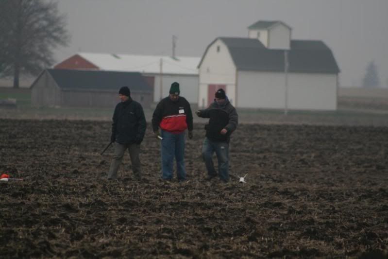

assesing the damage, yep a special guest appearance by Jeroen @ CTI
