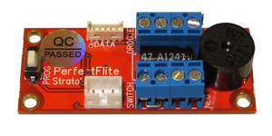

I believe that this question is related to, although somewhat distantly so, to the original thread. I 'm wondering if the original Stratologger SL-100 is in any manner different from the newer CF version, in terms of function? I understand the size difference.
I have two of the original full size products but am wondering if I'm missing any improvements in function or variety of information gathering by continuing to use them rather than the newer CF platform. I don't have the older information sheets to compare.
Thank you very much to any and all that can help.

I have both and there’s no difference other than size. Both have same programmable features. The only possible difference is you can add an LED to the CF. Not sure if SL100 allows that option.

Looks to me like the differences are:
Flight recording time: SL100 - over 9 min, CF - over 18 min
Output Current: SL100 - 10amps, CF - 5amps
Number of flights stored in memory: SL100 stored 31, the CF stores 16
Spec Sheets below:
SL100:
Specifications
  • Power: 4V – 16V, nominal 9 volt battery
  • Current consumption:1.5 ma
  • Output current: Do not exceed 10 amperes (actual current is battery dependent)
  • Output “on” time: 1.0 second
  • Launch detect: 160' to 300' AGL, default 160'
  • Main deploy altitude: 100' AGL to 9,999' AGL
  • Maximum altitude: 100,000' MSL
  • Altitude resolution:
    • 1’ up to 38,000' MSL
    • < 2' to 52,000' MSL
    • < 5' to 72,000' MSL
  • Analog-Digital Convert: 24 bit Sigma Delta
  • Calibration accuracy: +/- 0.05% typical
  • Meas. precision: +/- (0.1% reading + 1 foot) typical
  • Flight data logged: Altitude, temperature, battery voltage
  • Number flights stored: 31
  • Recording time/flight: Over 9 minutes
  • Sample rate: 20 samples per second
  • Operational temp.: -40C to +85C (-40F to +185F)
  • Dimensions: 2.75"L x 0.9"W x 0.5"H
  • Weight: 0.45 oz.
Features
  • Works to 100,000 feet MSL, audibly reports peak altitude and maximum velocity after flight.
  • Stores 31 flights of 9 minutes each (altitude, temperature, and battery voltage at 20 samples per second) for download to a computer with the optional DT4U USB interface. Data are preserved with power off.
  • Deploys drogue and main chutes with audible ematch continuity check.
  • Outputs capable of 10A current for 1 full second to allow use with nearly any ematch or ematch substitute. Reverse polarity protection prevents spontaneous firing if battery is connected backwards.
  • Main chute deployment altitude is adjustable from 100 feet to 9,999 feet in 1 foot increments. 9 presets allow for quick change in the field.
  • No mach delay necessary for mach+ flights: Automatic MachLock assures proper operation with any flight.
  • Brownout protection will tolerate 3 second power loss in flight – no need for multiple batteries.
  • Precision sensor & 24 bit ADC yield superb 0.1% accuracy.
  • Built-in voltmeter reports battery voltage on powerup – no more guessing about battery condition.
  • Audio connector for optional amplified external beeper or LED.
  • Post flight locator siren aids in locating your rocket. Especially useful when combined with amplified external beeper.
  • Confusion-free individual terminal blocks – unreliable multiple wires per terminal are not necessary.
  • Highly resistant to false trigger from wind gusts; tested in 100+ MPH winds!
  • Selectable apogee delay for dual altimeter setups prevents overpressure from simultaneous charge firing.
  • Low power design runs for weeks on a standard 9V alkaline battery. Post-flight locator siren will run for months, giving you multiple “second chances” to find a lost rocket.
  • Telemetry output for real-time data in flight with your RF link.
  • Rugged SMD construction, stringent QC testing, and internal self-diagnostics assure uncompromising reliability.
  • Wide operating temperature range of -40F to +185F.
  • Measures just 2.75"L x 0.9"W x 0.5"H, fits 24mm tube, weighs just 0.45 oz.
  • Backed by full three year warranty.
CF
Specifications
  • Current consumption: 1.5 ma
  • Output current: Do not exceed 5 amperes (actual current is battery dependent)
    • 1' up to 38,000' MSL
  • Number flights stored: 16
  • Recording time/flight: Over 18 minutes
  • Dimensions: 2.0"L x 0.84"W x 0.5"H
  • Weight: 0.38 oz.
Features
  • Stores 16 flights of 18 minutes each (altitude, temperature, and battery voltage at 20 samples per second) for download to a computer with the optional DT4U USB interface. Data are preserved with power off.
  • Outputs capable of 5A current for 1 full second to allow use with nearly any ematch or ematch substitute. Reverse polarity protection prevents spontaneous firing if battery is connected backwards.
  • Brownout protection will tolerate 2 second power loss in flight – no need for multiple batteries.
  • Confusion-free individual terminal blocks – unreliable multiple wires per terminal are not necessary. Dedicated switch terminal block eliminates the need for splicing switch into battery wire.
  • Measures just 2.0"L x 0.84"W x 0.5"H, fits 24mm tube, weighs just 0.38 oz.
