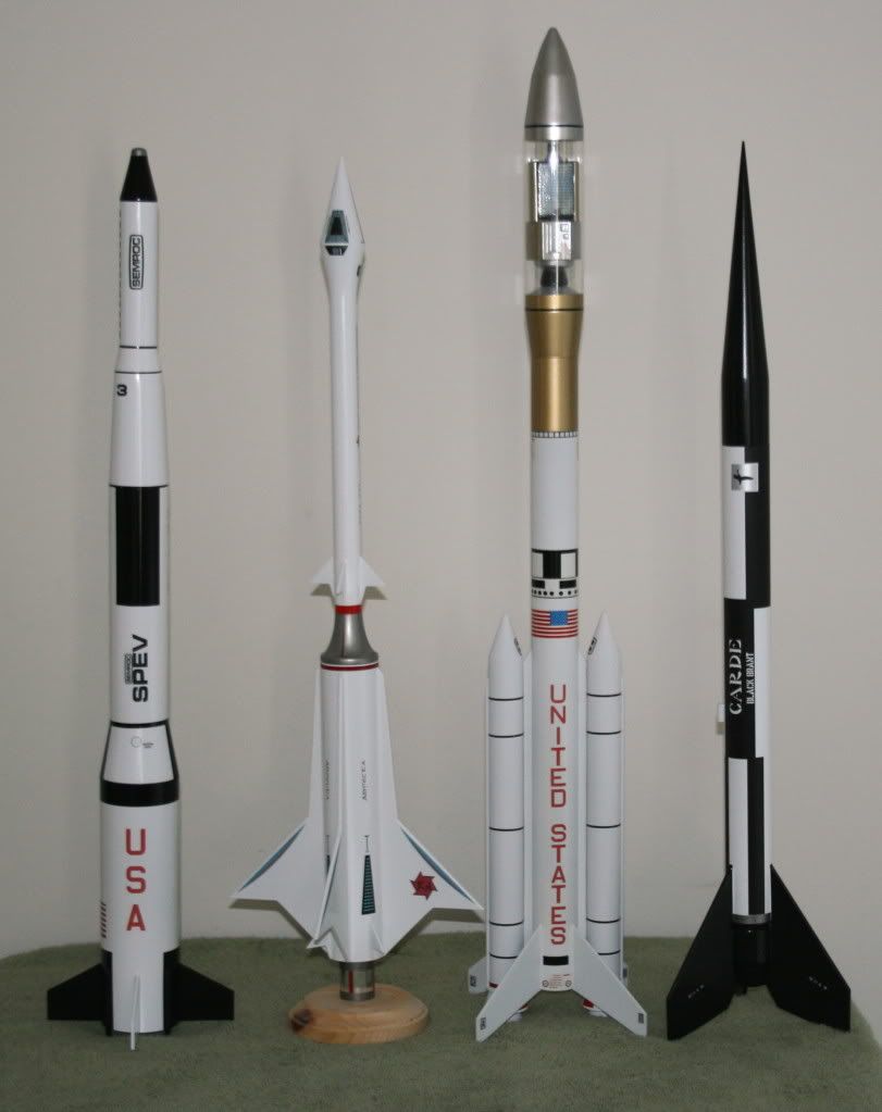

Semroc SPEV - super nice kit, some say it's an ugly design but I like it.
Fliskits Adfecta - great kit, neat design.
Geo Sat LV - Old Estes kit, modified to accept 24mm motors
Estes Black Brant - nothing needs to be said, what a rocket should look like.

Those are some beautifully built rockets! Your finishing is amazing.

Fantastic! I've definitely admired the Adfecta for a while. I need to get one of my own for sure! I love that one with the satellite. That's a cool idea. Beats a grasshopper any day (boo hiss on live bio payloads, BTW).

Looks like you have the Adfecta with the 8.6" long upper tube. If you fly it using an Estes E9 be sure to have the CG fall at least on the lower end of the launch lug to prevent it from going unstable.

Saaa-Weet looking Adfecta there :)
Yeah, it does look like the shorter tube. We had a problem with several kits going out with the 8.62" tube where it should be the 12" tube (the upper BT-20)... Makes all the difference with E motors. A little bit of nose weight fixes that concern though.
Great looking rockets all around!
