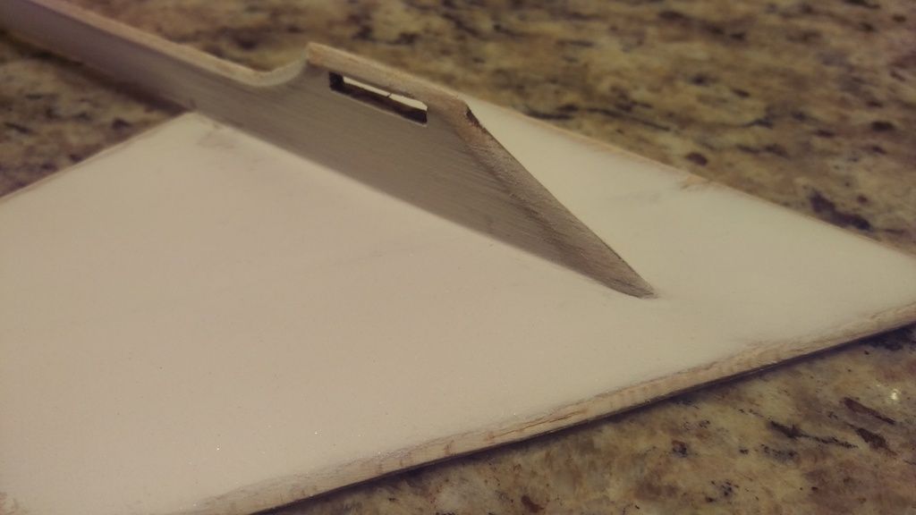

So here we go... I don't know if this was a good idea or not, but I'm committed now...
Spackling;
Pluses: Very easy to sand / Very precise control of surface / Only one coat needed
Negatives: Very messy / You will be sanding outside, then changing clothes
Has anyone else tried spackling, and have any idea what I will come across as I continue?

I've tried it. Not that much though. I wonder if it would be more prone to cracking when the fins flex.
I would think that you'd want as thin a layer as possible, just enough to fill the wood grain.

You definitely want to either make sure the entire kit is together before applying the spackling, or at least use a different technique for the body, because wood glue does not stick to spackling, I had to use Krazy glue.
I think I'll be okay, it seems to be hardening...
I've used this process on connection locations between fins and body, and haven't seen any cracking yet after firing, I just haven't used it over an entire wing, but will definitely do some extensive experimenting.

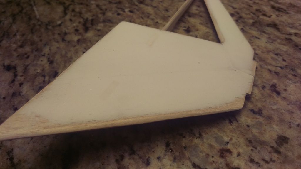

I am getting pretty good results from testing... Without paint, under stress, I'm not getting any cracking, and it appears the spackling is quite flexible, certainly more flexible then the balsa itself...

Still rough, but coming along...

It gets worse before it gets better...
I wanted to leave these wing supports off until after paint, and then blend them in later, but no...... The wings kept flexing and cracking at the body...
Probably another day of priming, touch up and sanding, before paint... I'm thinking German steel, but haven't decided if I'll do any fins another color...
