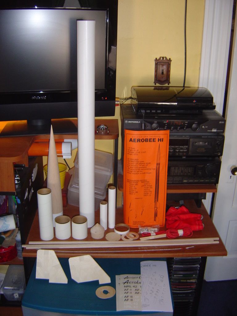

Hello all,
This is a build that I havw been wanting to do since I first saw this kit over a year ago.Since then I put it off a few times thinking I wasn't ready for it yet then it was out of stock for awhile.Then a couple weeks back Uncle Mikes Rocket Shop had them in stock so instead of another build I was planning I broke down and picked this up instead.Its gonna be a slow build but I think it will be worth it and also will be a good build thread to add to the new TRF.So onward with the build heres all the parts laid out.
I am going to be tweaking it a bit so I can fit in a Perfect Flight MT3G timer and a 9 volt battery that will be put into an E-Bay that will be built onto an extended motormount.Right now I am in the process of cutting and putting the extension to the MM I will post more pics sometime tonight or tomorrow of that.

Ooooohhhh...This one looks purdy. (DAllen subscribes to thread) Those cones and fins look awesome. Are you going with 29mm to 29mm?

Great kit...real neato when it stages.
I loved mine...(just make sure you use the G80-4 or an equivalent short delay in the booster....)
-DAllen
Yes it is 29mm to 29mm, first flight will probably ne a G64-4 to an F of some type.
