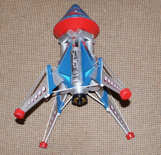

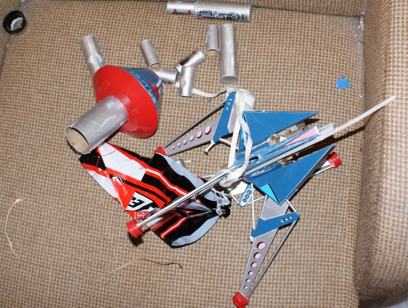

Today I flew a D15-L
Brand spankin new Estes Outlander (~$30 kit), upgraded to 24mm mount because I did not want the rocket to hit the ground before the chute deploys. I decided to use a D15-4T for its first flight.
Maybe Aerotech meant that the ejection occurs 4 seconds after it hits the ground? :confused: Cause that is what happened. The D15 ignites instantly, the Outlander shoots off the pad straight and true, climbs up to apogee. a four second delay would of been perfect. Starts coming back down. A seven second delay may of popped the chute in time. But no. impact. spectacular as bits of silver paper from the "tanks" fly in all direction. smoking. About four seconds after impact the ejection goes off. I needed a bag to collect the pieces.
After the hassles with Aerotech warrenty with my last two Aerotech motor failures/Issues (G71's and G53's), I honestly don't think its worth contacting them. They made it clear that they will not honor their motors purchased over a year ago and without receipt (and as a response, I don't stock up on Aerotech motors like I used to, I only buy what I know I am flying during the next few launches, and I encorage everyone to do the same). This is the last load of D15's which was purchased in 2007 and of course since it was purchase onsite vendor, there was no receipt...
Tonight I was going write a thread about my outlander. Guess I did but not with the tone I would like...

Ouch!!!
I hope you can somehow repair that.:(
Maybe Papa Elf will send another one.;)

Dude, that stinks, That rocket is such a time consuming expensive rocket to build to destroy it like that. (very cool rocket though)

Sorry to see the aftermath.....hope you can fix it.

ouch, wow i've never had that long of a delay by mistake...usually i scuff it with a razor before install just in-case...
