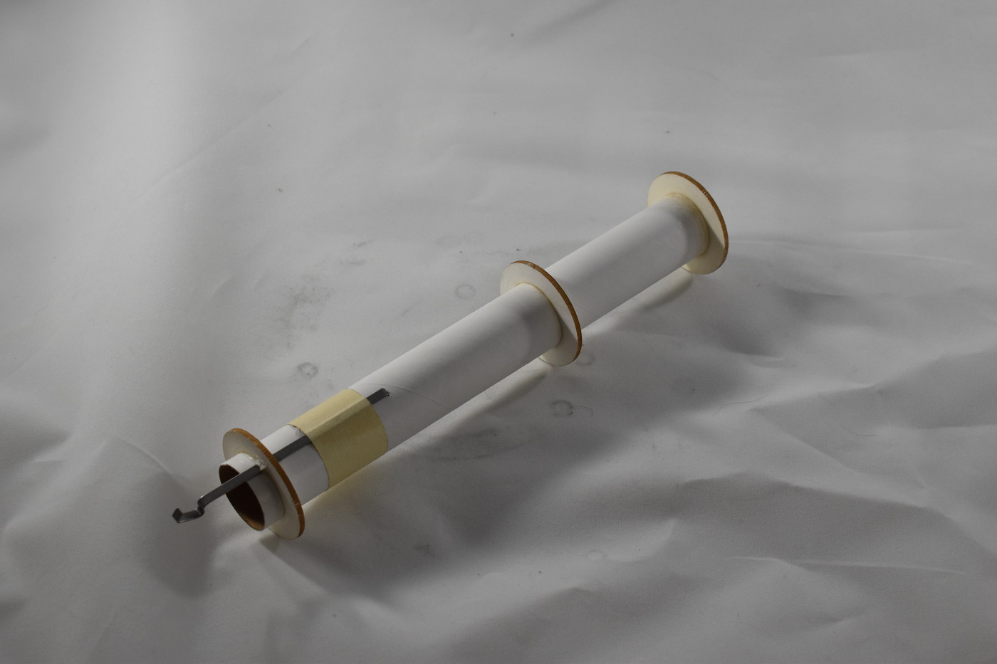

To start this project, I built a 24MM mount out of SEMROC BT50 tubes and rings I had on hand:
I used the estes engine hook. I decided on a 3rd centering ring because I had a lot of centering rings, and figured it might help it be more solidly held in place. And it looks cool. I also used a bt50 coupler I had as an engine block.

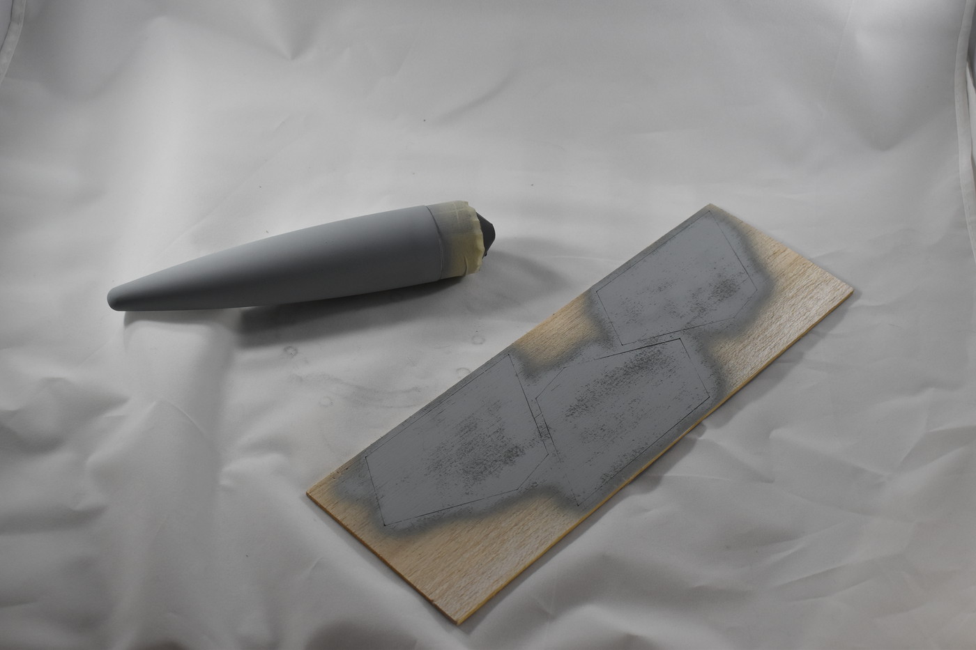

In the mean time, I sanded the seam from the nosecone, and applied primer. I also applied primer to the fins to fill the grain. I used rustoleum filler primer from walmart. I decanted some of the paint from the spray can, and applied it with a badger 250 mini spray gun. This provides a large spray pattern, yet gives more control than a spray can without half the paint becoming overspray.
Next step sanding, and engine mount installation.
