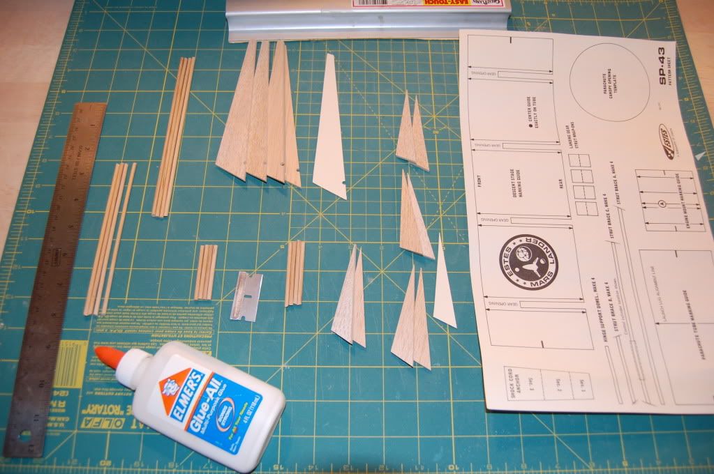

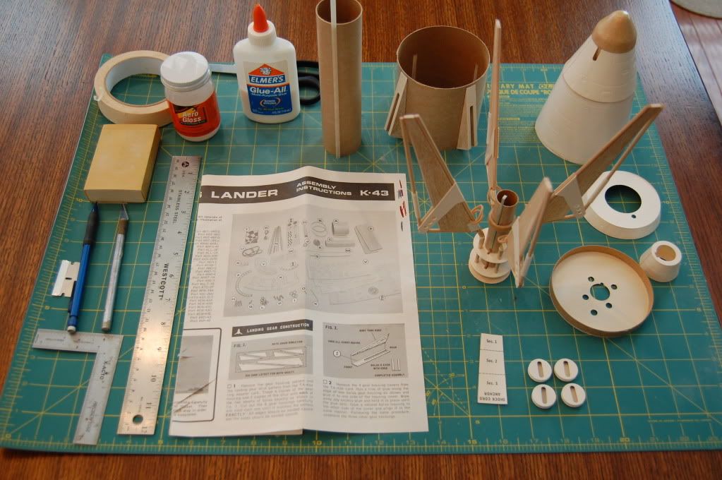

    Ok here are the pictures of my Mars Lander build. So far this has been a fun project and not as difficult as I thought it would be. The more difficult kits that I have built have been the kits with plastic........Space shuttle, X-Wing fighter and the Star Trek kits..... But I did have some measurement issues as stated in the above post. I did nothing with the dowel were the rubber tube attaches since there was enough exposed dowel. I just made sure all 4 legs were identical in length. The housings, I just cut a little longer than the pattern, I then sanded them to the correct length so they are even with the bottom of the BT and 1/8 from the top. Other than that the shrouds are old and discolored but they matched up perfectly. The braces and all the rings are made from index card material not fiber board, so they are flimsy. This may also have something to do with the age of this kit. Elmer's glue-all has been perfect for this kit, keeps everything clean that's why I like it. I have 3 of these kits and 2 Semroc kits. I love this kit. So what I can tell you is that the Semroc kit is better quality when it comes to using fiber board vs card stock. The Semroc wraps are right on except Estes did a better job of deeper embossing. I look forward to building the Semroc version and using springs for the landing gear for a durable rocket.

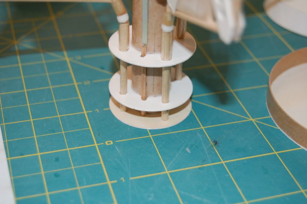

    All the wood pieces are cut out and the housings are a little longer than the pattern. Next I will seal with 3 coats of balsa sealer.

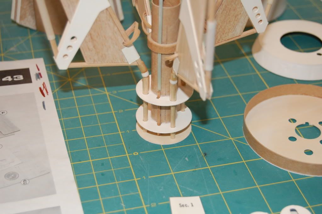

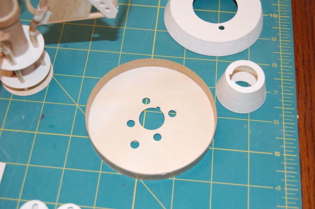

    All the pieces have been put together and the wood has been sealed. Next is to add the fillets and begin painting via sub assemblies.

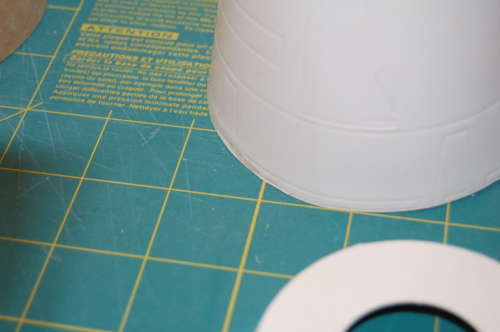

    It is real important to make sure all the parts line up perfect. I had to read the directions multiple times to make sure I was doing everything right.
    The wraps have excellent detail, but they also so their age. The wraps have some age spots and rough spots I will have to take care of with primer.

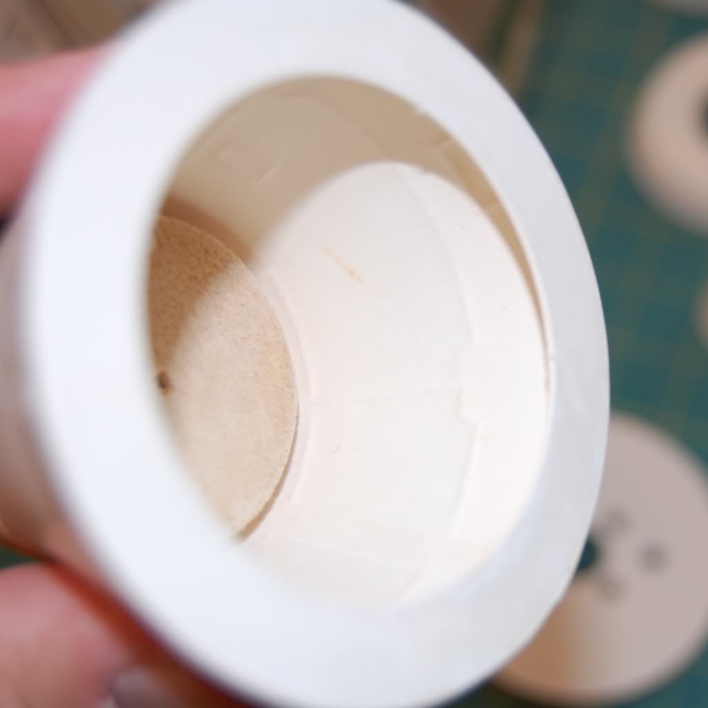

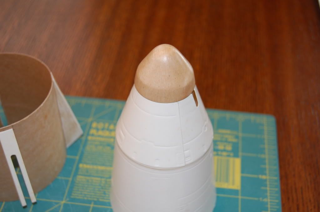

    The balsa nose is old but filled nicely with a few coats of balsa sealer.
    You can see the flimsy card stock that is used in this kit, fiber board would have been much better.

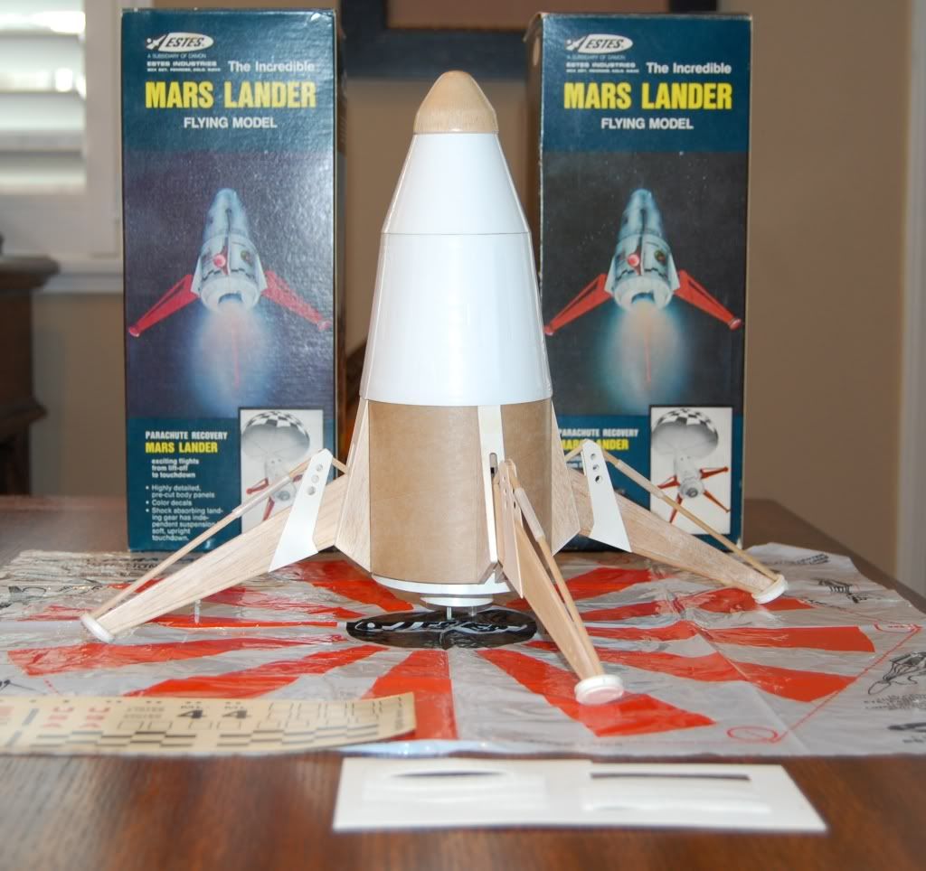

    Well everything is being held together with friction, still have to paint the sub assemblies. I will use one coat of white primer on the wraps since there are stains I have to block out. Then I will spray light coats of glossy white.

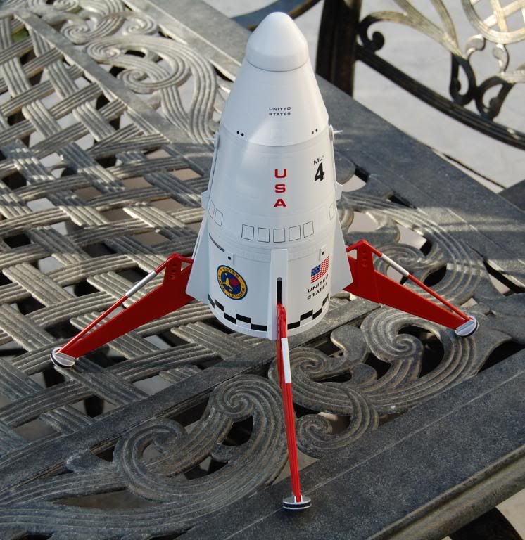

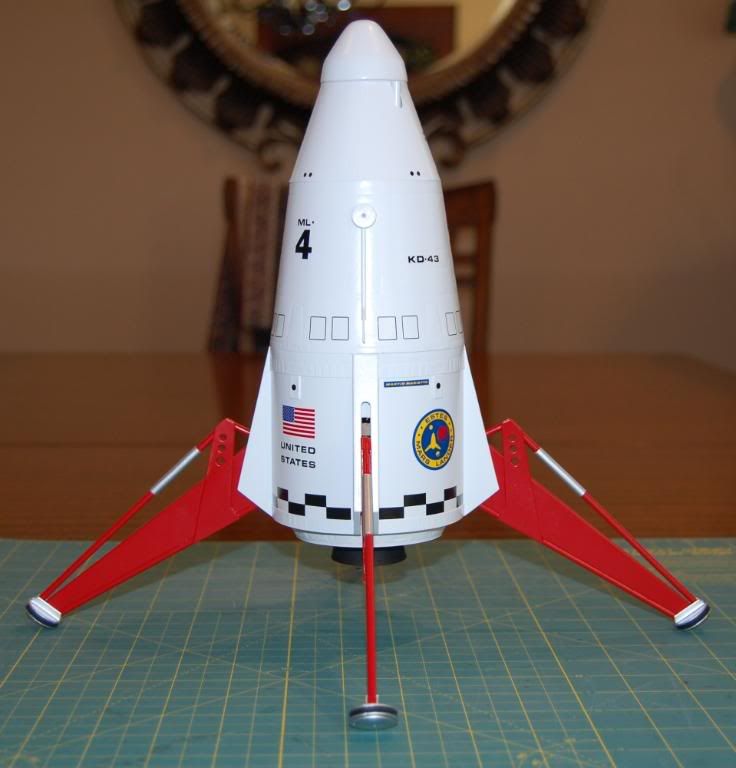

    I was able to finish my ML today, can't wait to take her to the field.
    Maryland
    2,818
    Gorgeous.
