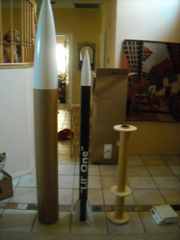

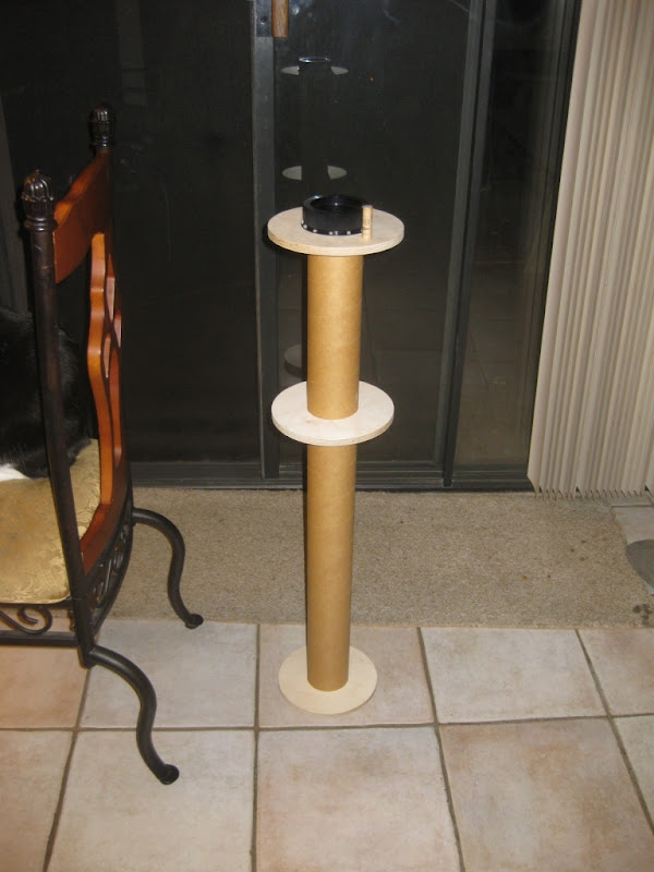

    Thats the motor mount with an Estes "A" motor on top. That is a nice Aeropac flange 75mm retainer mounted to the last ring. I really love the look of those aeropac retainers.
    Thats the motor mount next to my Level One rocket then next to the bare airframe.
    Tell me thats not cool looking! I can't imagine it with a 75mm motor in it..RAWR! haha

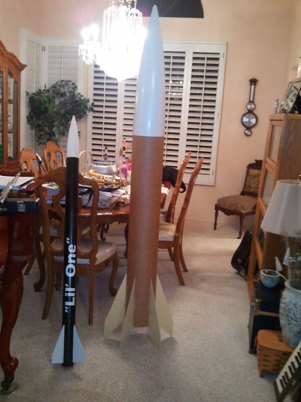

    Ok So heres the full rocket with fins standing full length at 82" tall (6ft 10")

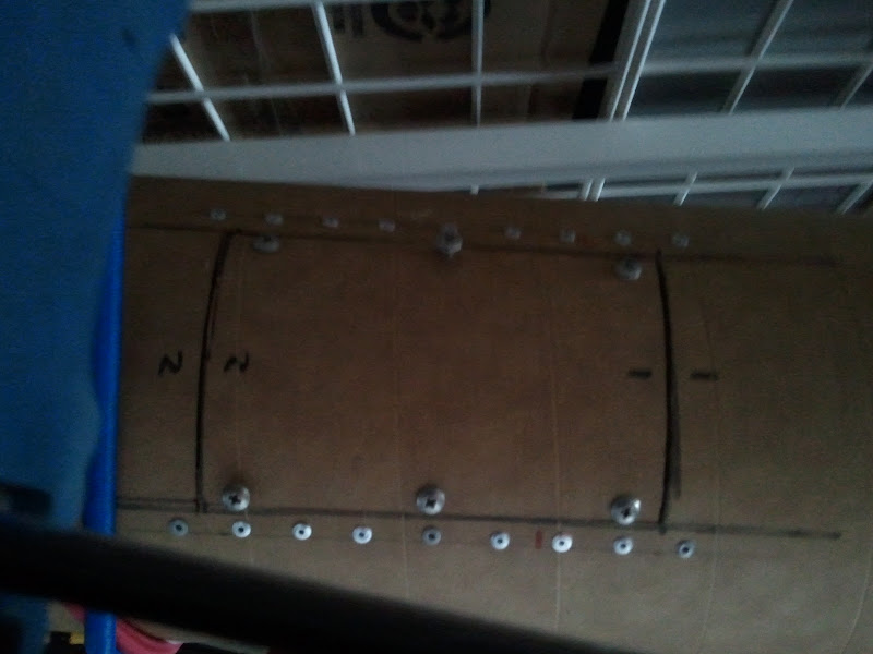

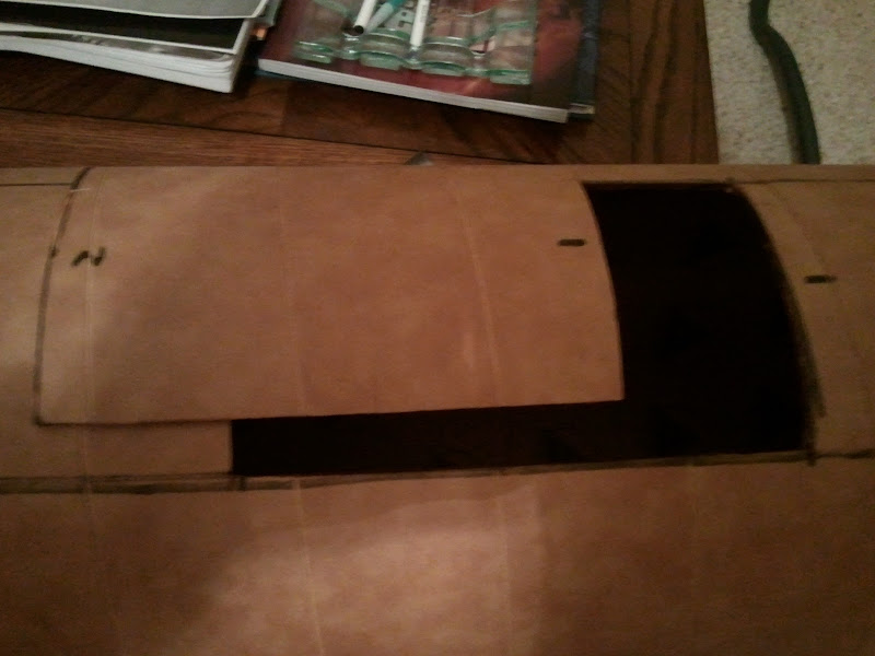

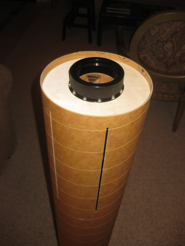

    Another goal I had for this project was to include an AVbay in the Body of the tube. Since the last centering ring is 36" up from the aft of the airframe there is alot of wasted space between the forward centering ring and the centering that sits right above the the LE of the fins. So I drew some lines and used a Dremel to cut out a 4x6 hatch.
    Its not perfectly straight as it was my first time using the tool but it will work really well. I made a brace out of aluminum and riveted it to the wall I don't know why I used that many rivets but better overkill than underkill.
    I then tapped the brace where the holes I drilled were and added 6 screws and that thing is NOT coming off!!!.....But the problem will be on launch day if something happens it might take a while to get off. I know! And I'm working on it.
    Oh forgot a picture here you go
