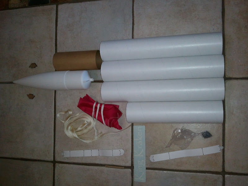

    Here is a picture of everything that comes with the kit
    As you can see it is very through
    It comes with a nice 28" parachute all the shock cord you will ever need.
    It even comes with a bag of small dark heavy things, I guess to throw at my sister and feed to my dog? (Dog -----> )

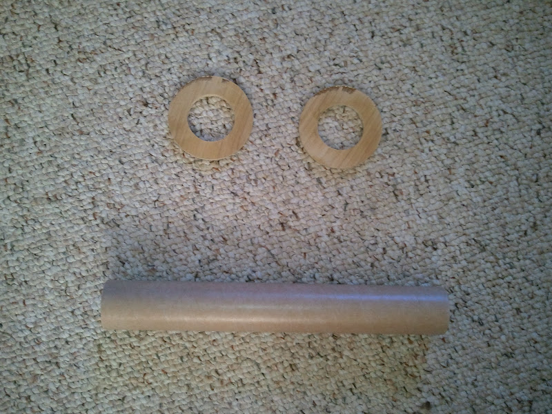

    I forgot after I took that picture that the motor mount and centering rings were inside one of the airframe tubes. So I had to show you what they look like...and to me it looks like money I could be saving with Gieco

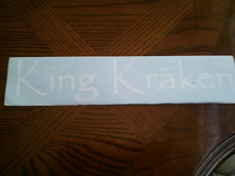

    Edit: A set of decals came with the kit (they say "King Kraken (in case you've forgotten by now(or can't read(well then spelling it there didn't help (Wow thats a lot of inner parenthesis (I bet thats illegal (ok really on with the thread)))))))

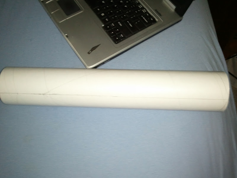

    Ok we all have to agree that the coolest part of this kit is the tube-ish fins.
    They are also in my opinion the hardest part 20% of the work is being able to decode the destructions and to mark the lines. I guess I'm kinda on the stupid side and after reading the steps 8 times through, upside down, backwards, after calling my therapist for a check-up, and discussing with my guidance counselor whether to continue this build or not. I finally got the lines drawn on the tubes....correctly. (BTW I used the kind of measuring tape they use for tailors and stuff, worked great!)

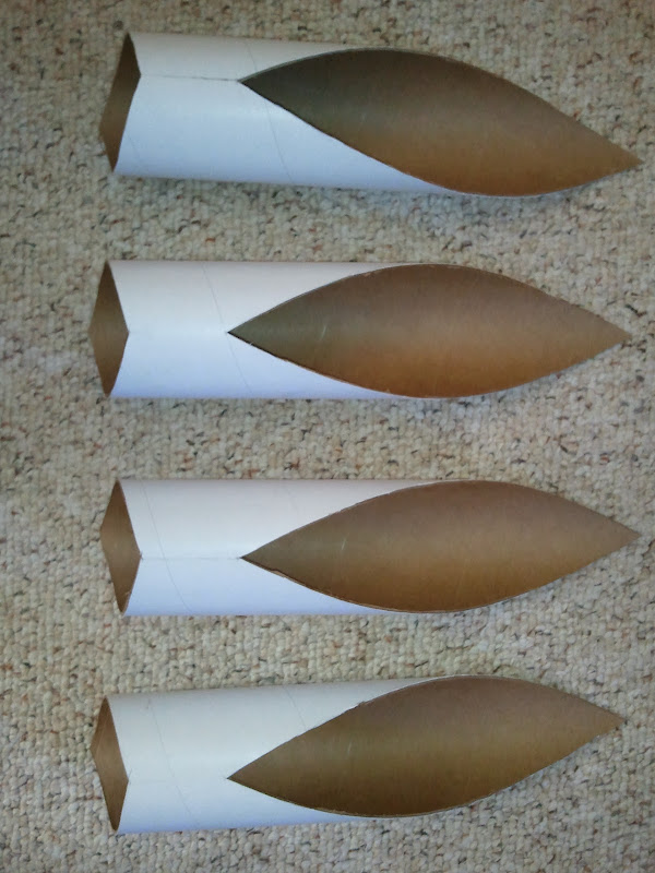

    After that madding event I was ready to cut the tubes into a Million pieces!!! Luckily with two sessions with my personal psychologist I got thing straightened out and my life back on track.
    There are A LOT of tricks to these fins, most of which are completely obvious after you screw something up.
    Things to keep in mind while cutting psychotic paper tubes!:
    1. ALWAYS use a sharp exacto knife. (you don’t want rust on your fins)
    -36. When drawing the lines make them DARK (So you can see them with your eyes closed)
    2. Open your eyes so you can see what your doing (Ya it really does help)
    3. Stay above your work (helps with #2)
    4. Don’t believe what your kindergarten teacher told you about “staying inside the lines” you better stay ON those lines
    5. 15 shallow cuts are better than one deep cut.
    6. The only exception to rule #5 is crazy Jim who is allowed to use a chainsaw when cutting paper tubes!
    That’s it that’s all you need to know!
    So here’s my final product
    I need to sand the ends but they came out relatively ok.
    What’s the best way to sand paper tubes without making them all fuzzy?

    Yep - I'm building a (regular sized) Kraken right now, and the tube fins are definitely the hardest part. Mine aren't quite as even as yours, but they should be functional.
    NAR #84281 L3
    TRA #11233 L3
    Fort Myers, FL
    578
    The King Kraken is a great kit. Here is a pic of mine flying on an H123W.
    Looks like there was a change made to the kit with there being more tubes and a tube coupler included. My kit only included two tubes, one being a 30 inch for the main tube and a 34 inch one to be cut up for the tube fins.
    The tube fins definitely make for a challenging build but the end result is well worth it and the build goes fast once the tubes are cut.
    Good luck with your build and maiden flight.

    Ya the kit stopped coming with the long tubes and instead comes with three 17" tubes and one 13" tube and a coupler (13+17 adds to the main airframe) and the 2x17 is the 34"
    I think it also cuts down on shipping too.
    BTW I thought I would run this across you guys first to see what you think.
    Before I glue the coupler to the tube I thought I might glue th coupler to upper (13") tube and add a bulkhead and eyebolt to the bottom of the coupler and make an AV-Bay.
    What do you think?
    Stability: Well since all the additions are in front of the CP all it can do is help right?
    I'm not going for altitude but I always want to know how high things go!
