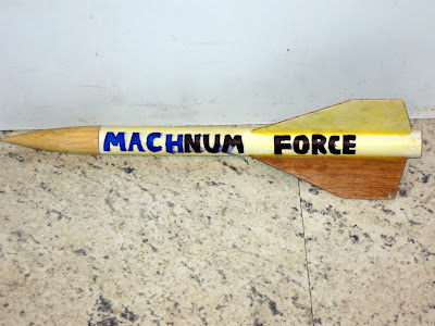

    My second attempt, the 29mm Machnum Force. Lessons were learned; it had large plywood fins, a smooth strong coating of hardened wood glue, and enough nose weight for stability. It flew to (simmed) just over Mach on a G78G at NERRF 5.

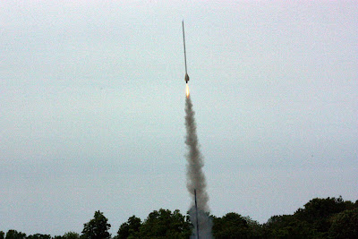

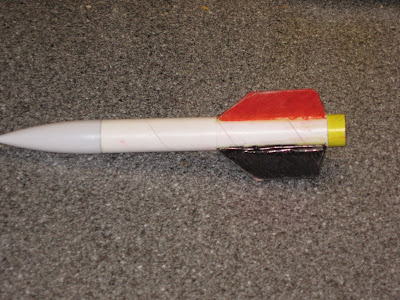

    And now, my third and best, the 29mm Sudden Mach. (No, I never get tired of the puns...) It's made from all conventional materials - plastic nose cone, paper tubing, 1/8" basswood fins - except for the blue tube couplers. (I needed the length.) It's got a long, skinny avbay that can hold a timer or DD controller.
    First flight on an E18W:
    Painted:
    And, the second flight, drag racing Crazy Jim's Blackhawk, and an unidentified rocket, on a G78G at NERRF 6. Jim Flis caught this great shot; I believe the Sudden Mach is on the left.

    O.k. Here is my new minimum diameter 29mm Rocket. It will* fly on a G75 Metalstorm at Hellfire 16. It should just break mach on a G75 hitting mach 1.03 (simulated on open rocket.)
    Stupid paint courtesy of my stupid stickers.
