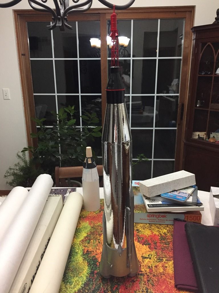

    We are silvered.
    What I learned: the squareness of the strips - how well the ends line up when they meet up 360 degrees later - drifts over the course of all little segments between the equipment pods. I squared it all up again by letting the gap be a little bigger than perfect. I wound up at the top with less than a mm hanging over.
    I do have a couple little wedge-like areas that won't stay stuck down. I'm thinking of wetting a toothpick with CA and making them stay down. I'll have to test it on the left over border scrap, first.

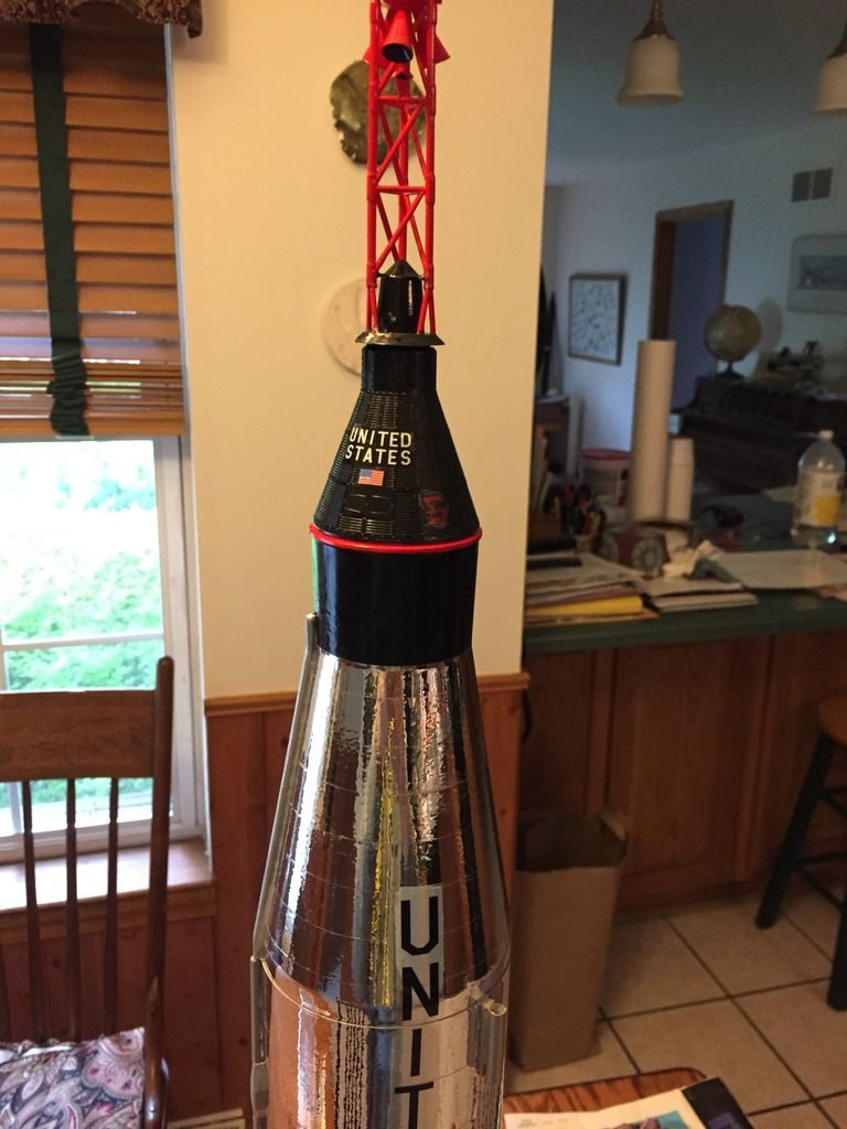

    I'm not going to paint the fins before flight. So here she is, with everything except chutes.
    I went for Wally Schirra's Sigma 7 flight - I like the logo.
    What I don't like are these decals. The capsule decals slid off the backer and laid down fine. But won't stay down. The Sigma 7 was brushed off and broke right after this picture. I'll have to reprint it. The booster decals ar the thickest, toughest I've ever seen. They wouldn't slide off - I had to peel them. The clear is a bit milky right now, but it looks like it might dry out okay. The decals have been the worst part of this build.

  29. #59
    12th September 2013
    SE Wisconsin
    1,131
    Equipment pods and shrouds
Name:	ImageUploadedByRocketry Forum1496720644.946069.jpg
    Charles McGonegal
    Ciderwright at AeppelTreow Winery & Distillery
    www.appletrue.com
    NAR #103560 L1 6/25/17 Estes Leviathan CTI H175-SS
    Ad Astra Tabernamque!
  30. #60
    12th September 2013
    SE Wisconsin
    1,131
    Some progress on details: lines and thrusters.
Name:	ImageUploadedByRocketry Forum1497232280.696460.jpg
Name:	ImageUploadedByRocketry Forum1497232305.974316.jpg
