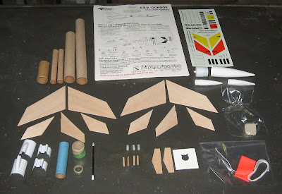

    The parts:

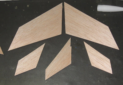

    One set of glider balsa parts:
    And the decals:

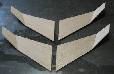

    Got the 4 half-wings glued together:

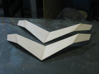

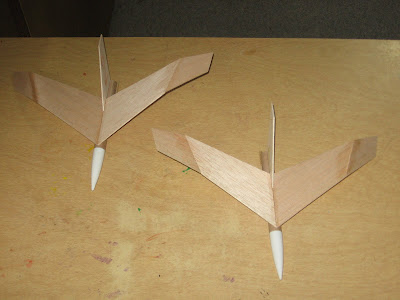

    I got lots of work done today. Glued the wings together:
    Then assembled the gliders (nose cones unglued):

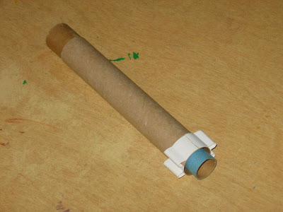

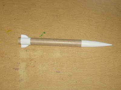

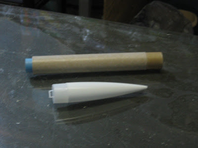

    Glued the main nosecone together, and the coupler and motor mount into the aft tube:
    Then got the glider holders on the aft tube:

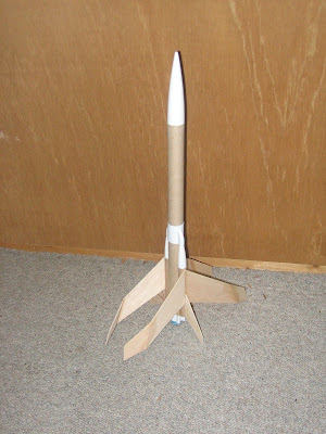

    After some more building, the Condor is completely built.
    First, I tied the shock cord to the nose cone and glued it to the upper body tube. Then, I glued on the upper glider mounts. CA is a wonderful thing.
    Then, I put on the finishing touches. The three mini launch lugs were attached - one by the lower glider mounts, and a pair above and below the mid-body joint. Finally, I glued the lower end of the shock cord into the coupler, and it was complete:
    Now comes primer, paint, and decals - a process lengthier and more difficult than building.
    I also test-chucked the gliders in the yard. #1 flies nicely with a small intentional left-hand curve; #2 dives to the right which will be corrected after finishing.

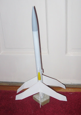

    Got some painting done over the last week. The boosted is primed and completely painted. The gliders are primed; the nosecone of the #1 glider is painted.

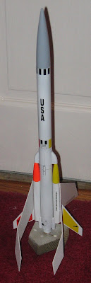

    First flight today on a B6-4. Ejection was late; I should have used a -2. The gliders did not glide very well.
    All three pieces landed in thick knee-height weeds, but thanks to a couple of the guys from CATO and some CAP cadets, I got everything back to fly again.
